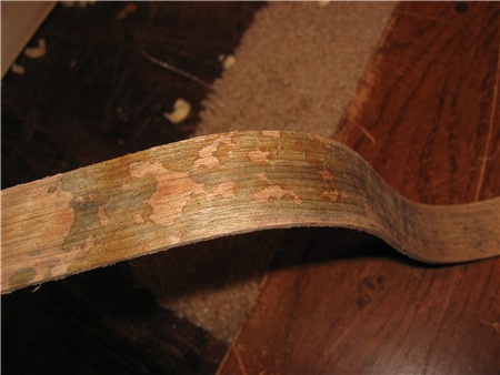

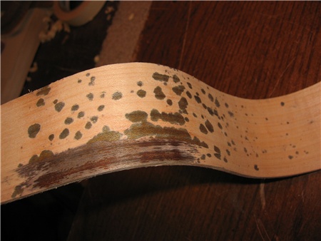

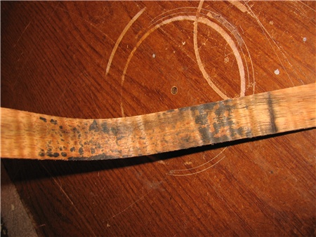

Stained maple test
Stained koa test
Stained myrtle test

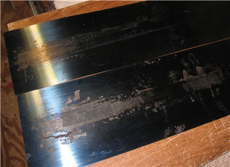

Spring steel slats
Is it normal for spring steel to look like this after only experimenting with them a few times.

some woods could react with the spring steel, but you didn't mention whether you used distilled or tap water.
i use distilled water and alfoil to try and eliminate staining problems.

The stain is a combo of issues oils in the wood, water, ambient dust particles and a bit of galvanistic staining. I have had the same issue on some woods when using Kraft paper. I will sand off.
Yes the spring steel will oxidise from the heat just keep them clean of dust and oils from the woods and they will be fine.

Michael, how do you clean your slats? Mine seem to rust extremely fast. I've been using an extra fine steel wool (0000 I think) to take it off. Do you think this could be causing any problems?
PostPosted: Thu Oct 04, 2007 3:11 am
It really is not rust per say it is oxidation of common air borne contaminates, oil and minerals in the water.
(use only distilled water every where you use water!!!!!)
I just wipe them down with Naphtha after every use. I will not get rid of all the oxidation on the slat but will control it
If I am not familiar with the wood I am bending I bend in Alum. foil to help prevent the staining.

Once the bluing on your spring steel slats wears off, they will rust very quickly. Different woods will react differently on the naked steel, causing all kinds of staining problems.
I tried painting my slats with high heat engine paint. Turned out to be a bad idea... The paint softens up with the heat & gets sticky enough to transfer to adjacent surfaces.
Even if you are using stainless steel slats, I believe its important to wrap the side in foil. (I know lots of guys get away with it, but I'm too chicken to try it.) Unless the slats are spotlessly clean, you never know what reaction you'll get when you add water & heat & then leave the whole package to stew overnight.
I always wrap in foil, but for the drying cycles, I use a box knife to (carefully) slit the edge of the foil. this allows moisture to escape freely while maintaining a foil barrier between the wood & the slats.
I should mention that some woods (Koa for example) will stain in contact with aluminum foil. A wrap of parchment paper works to separate the wood from the foil. Craft paper may work as well, (& less expensively) but I haven't tried it. After replacing an expensive set of Koa sides, I'm happy to fork out the $ for parchment paper... But I'm a braces & belt kind of guy.
